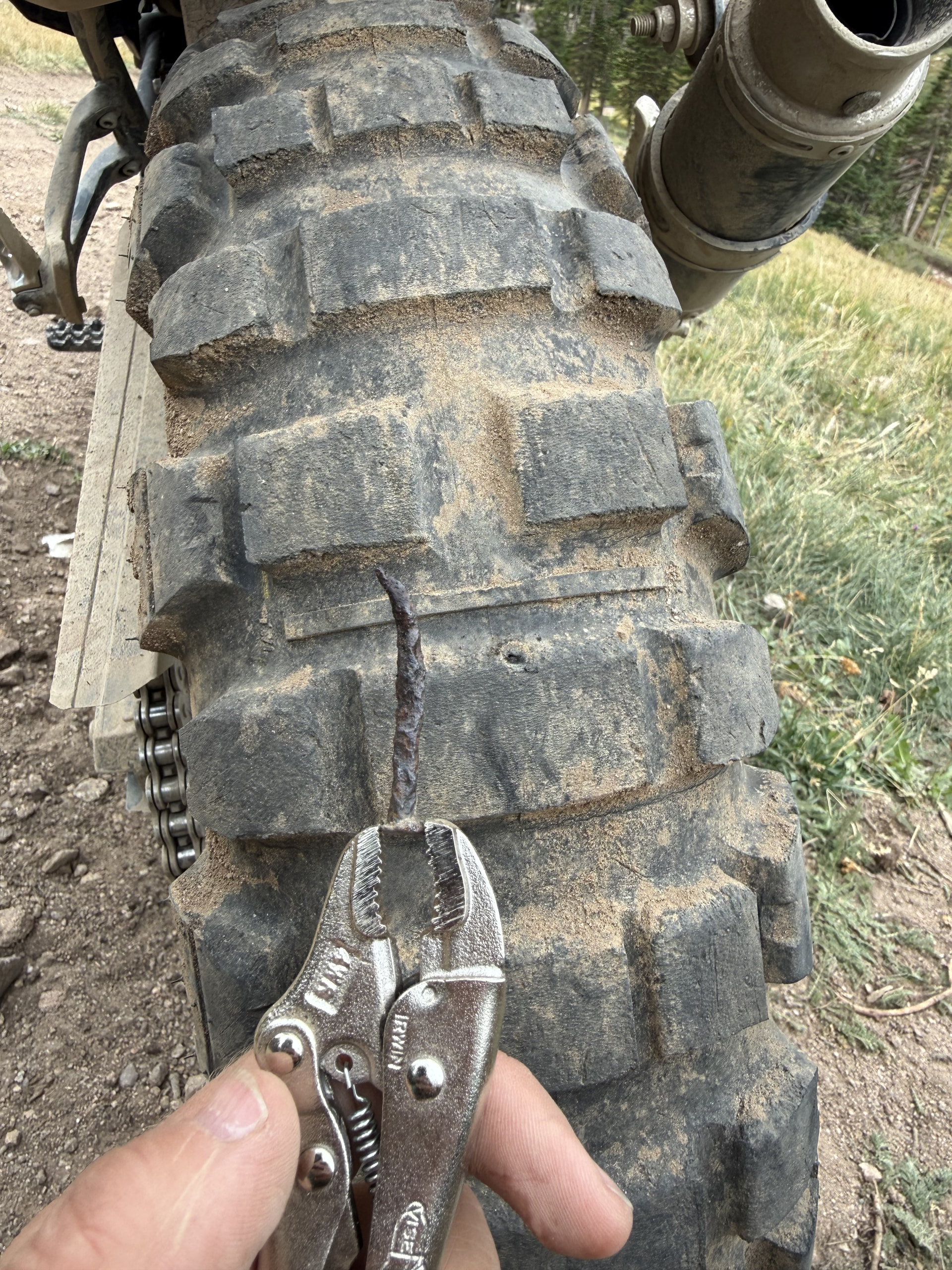

On my recent camping trip up Rollin’s, I found the only nail on the pass with my rear tire. Foolishly, I had recently acquired a basic repair kit, excluding any sort of flat repair kit… Lesson learned. Fortunately, some other riders had spoons, a 27mm wrench for my rear axle and a tube stem finder tool.
