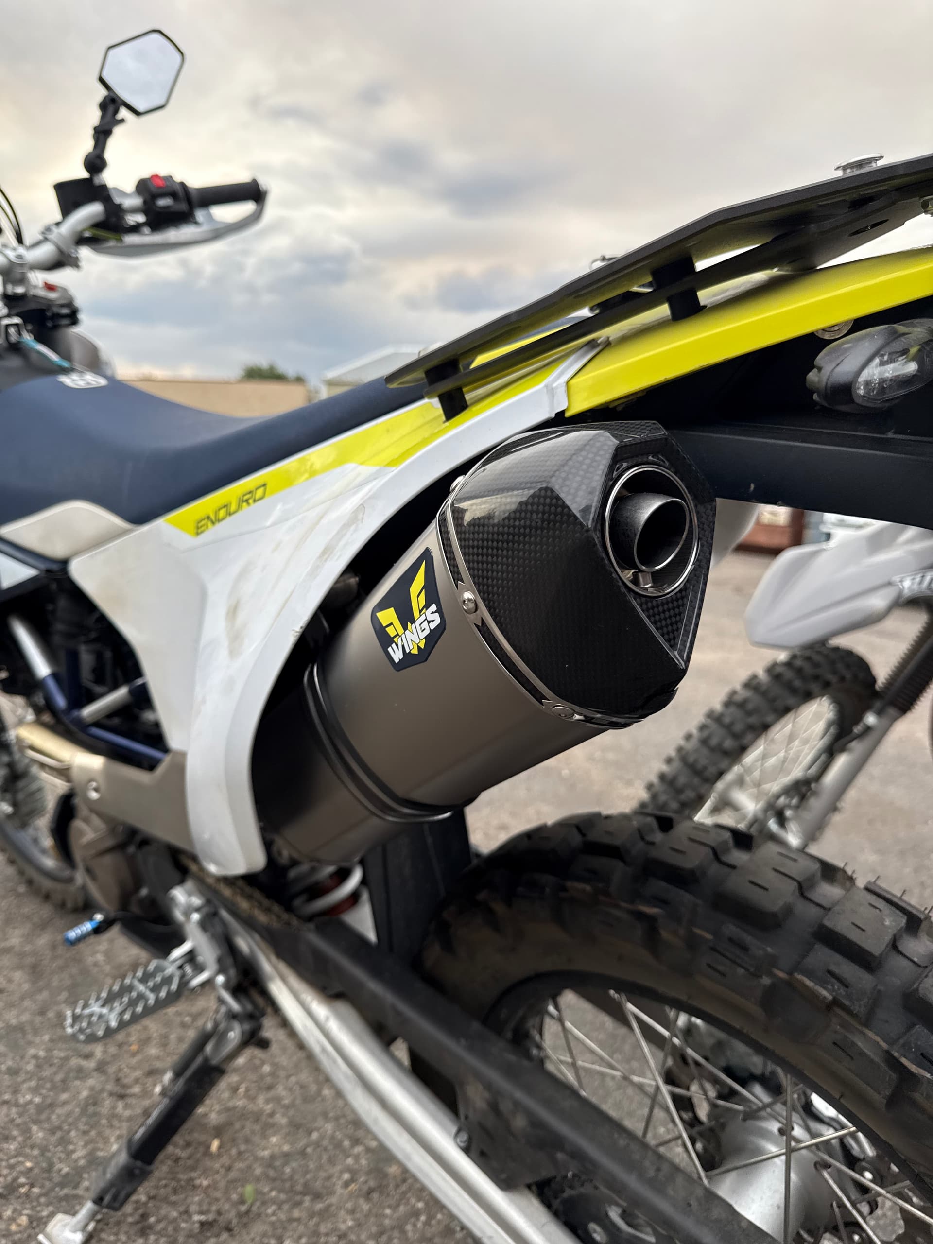

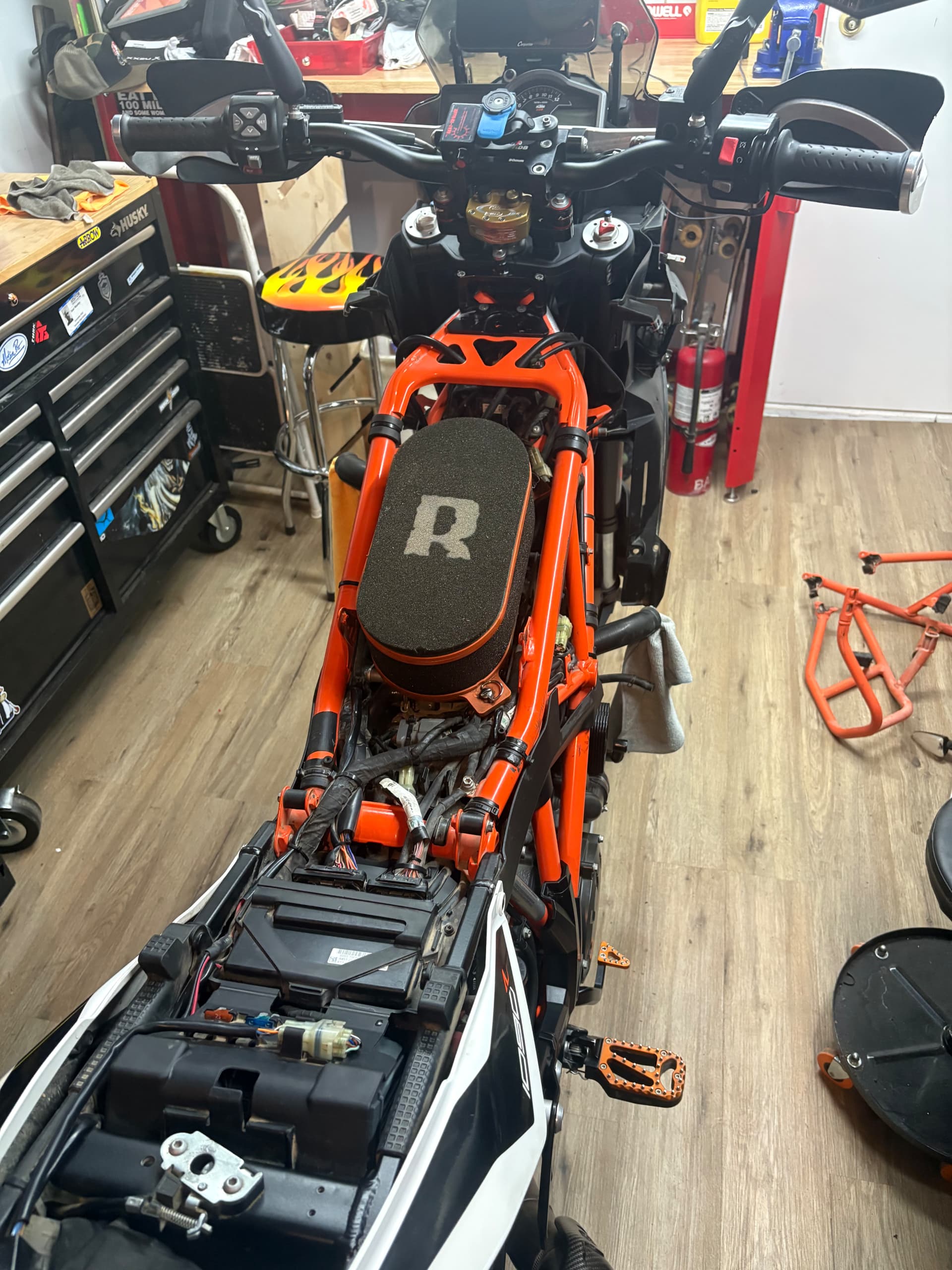

I’ll go first. :slight_smile: In an effort to cool down my Husky 701, and address some of the fueling flameout issues on steep/loose terrain I ordered a Dynojet Power Commander and a Wings exhaust w/dB insert. These will be paired with the Rade Garage air intake that comes as part of their under seat storage compartment kit. I’ll report back once installed, and if anyone knows of a Dynojet dyno in the area, I’d be curious to take it to see what the numbers look like.

The Rade intake filter has a ton less filter surface than the factory paper filter or even some other intakes on the market. The filter cover sucks and the elastic around the bottom of it will work under the filter seat, leaving a path for dirt. Due to the smaller area, they get dirty fast, especially when riding in a group. Get a Funnel Web filter for the from here Funnel Web. They are Funnel Web but for some reason can’t license them as such in the US. I’ll carry 1-2 extra filters in the storage compartment.

Wings exhaust with a Power Commander is on the 701 now. I’ll go for a little rip this evening to see how she feels. Hopefully cooler and smoother down low.
Next, I’ll likely add a slightly larger rear sprocket. The 701 will do about 22mph in 1st gear in steep downhill stuff, which is less than ideal… and luggy low end stuff could be improved.

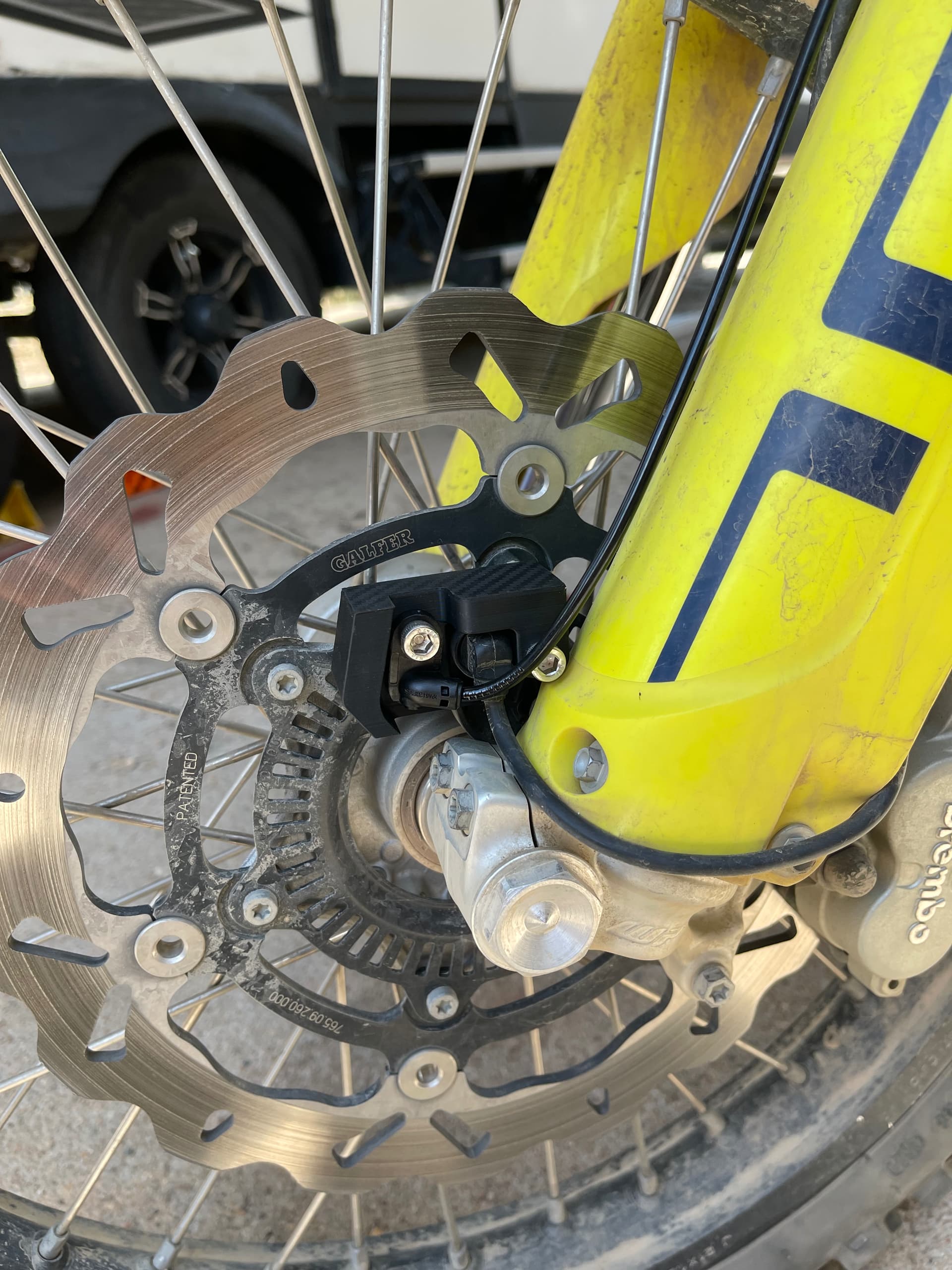

Fixing some 1st world problems on my 701. Got a bracket from ADV Crew out of Australia to double up ABS sensors on the front wheel. This takes the rear ABS sensor and puts it on the front wheel so the system doesn’t see slip. Therefore 701 can switch these off but when you turn the key off, it resets then you have to go over like 8mph and turn them off again.
There are ABS dongles all over the market but nothing that fixes the traction control issue. This does both without throwing any errors like putting a washer under the ABS sensor bolt does. I’m waiting on some switches to be able to switch between this way and normal.
I don’t know if it was in my head but I also think this works better than the factory switch as I think the front ABS was always active to a certain degree as it felt like I had brake fade on other rides. Yesterday the front brake felt great all day.

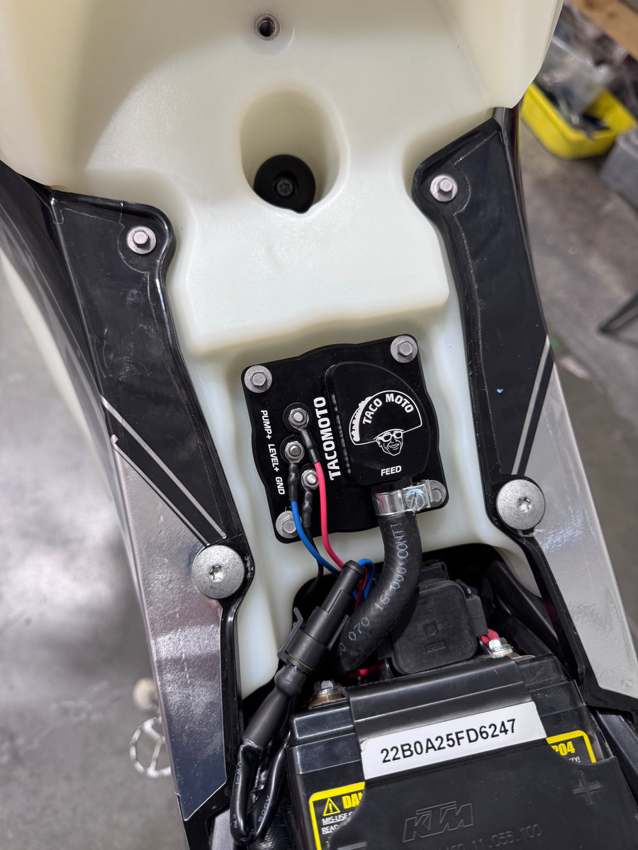

While at Dusty Lizard, the Taco Moto crew installed their double snorkel double draw system on my 501. Now, the bike will suck every last drop of gas, and not leave that trademark KTM 1L of fuel while behaving like it’s empty.
