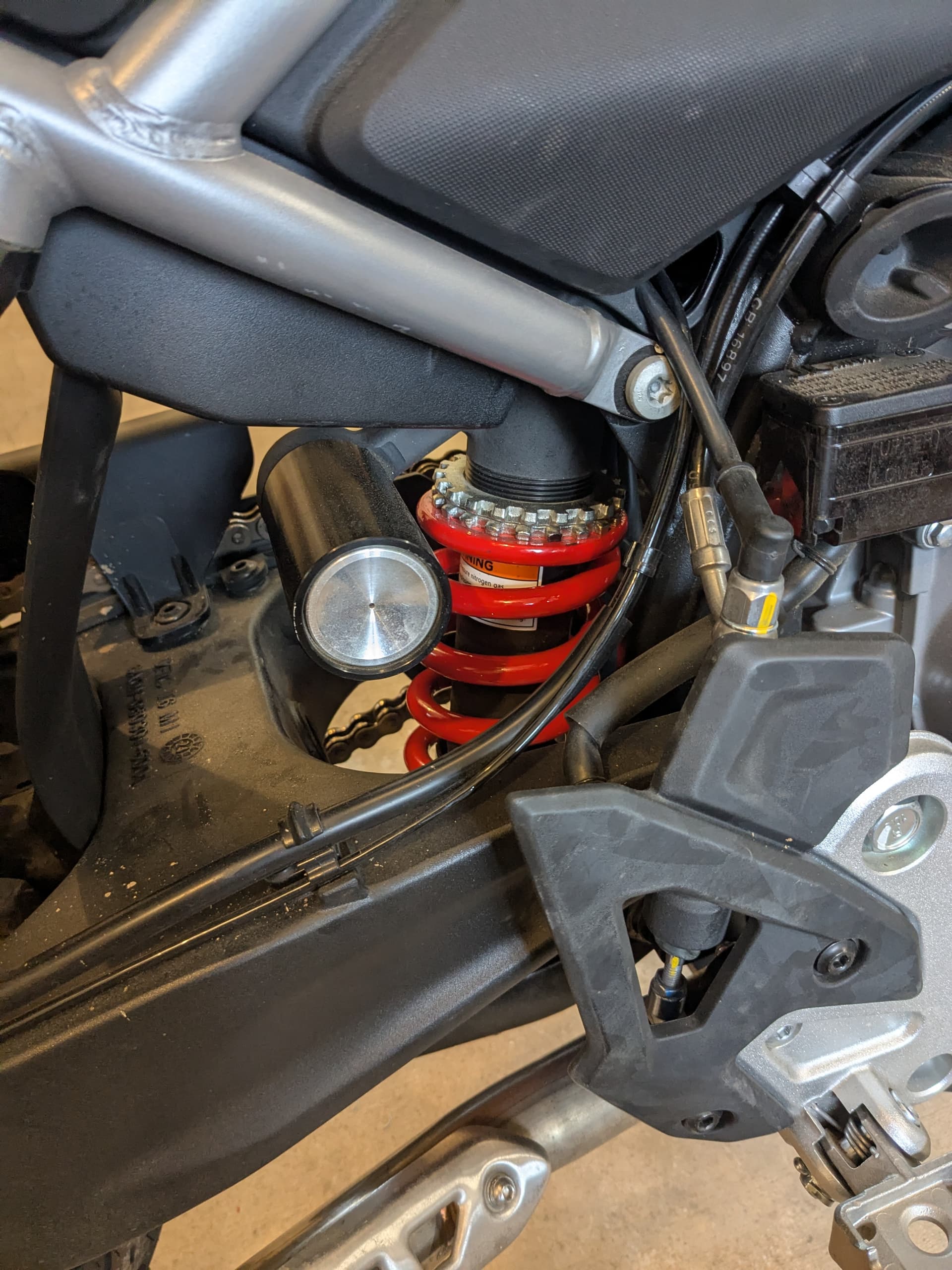

Speaking of suspension, I just installed a lighter KTech spring in my shock and the bike rides a lot better. Especially uphill washboards where I felt like I had no traction with the stock spring. Fork springs might next!
