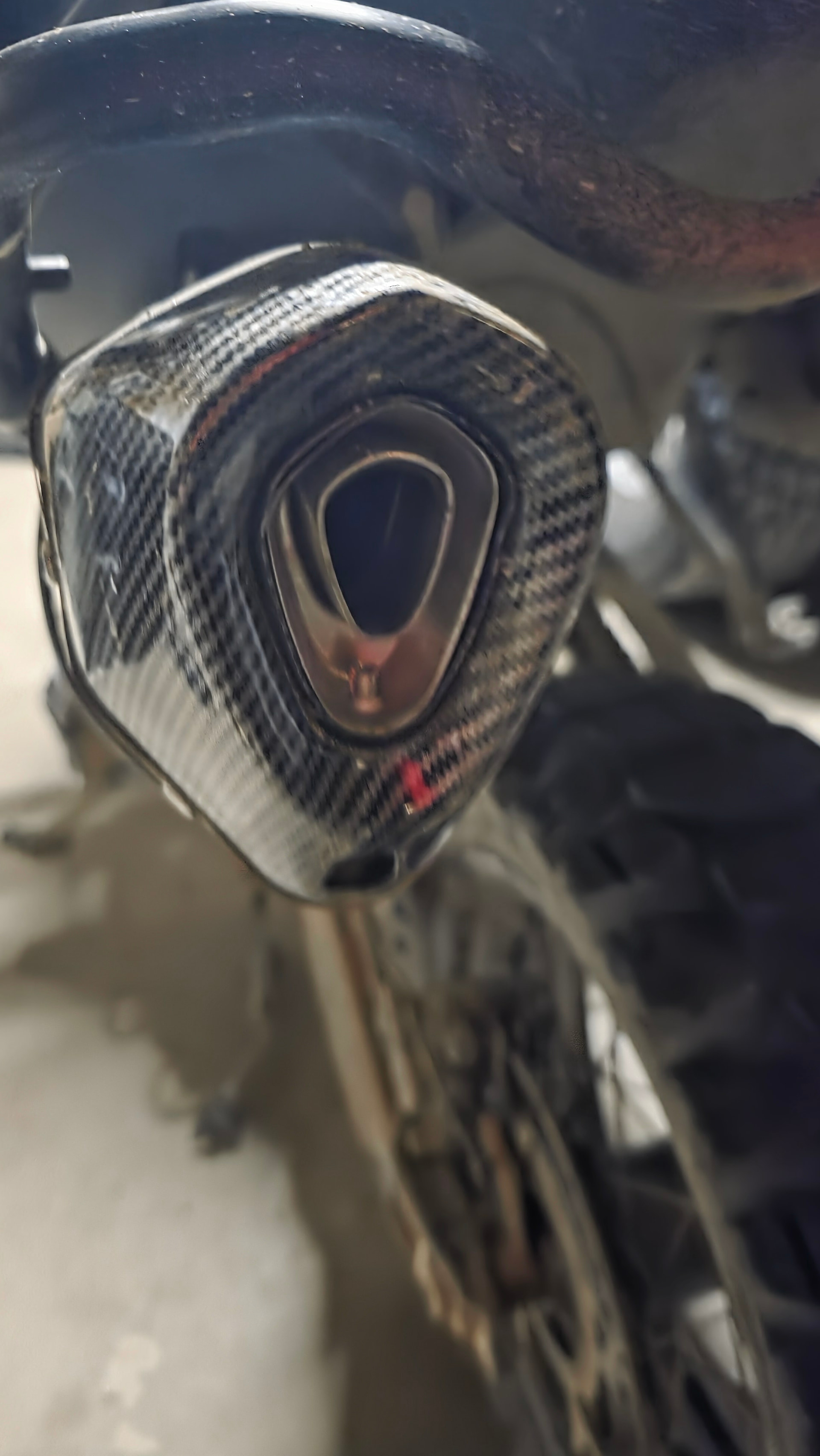

A few months ago, I replaced the dented factory muffler on my F800GS with an ebay chinese muffler. It’s smaller, lighter and more free-flowing than stock. It definitely sounds more aggressive than the stock muffler. Today’s the first time I’ve actually ridden the bike since putting it on there. Now I get a lot of decel pops, and there is a notable reduction in torque from before. I didn’t realize that a more free-flowing exhaust robs you of torque. Now I know, dang! There is an insert that came with the exhaust that I need to put in and see if it makes a difference. I left it off because it sounded better at idle. But now I think I need that restriction. I guess this is how you learn.

How a bike sounds is more important than how it performs #priorities
The insert is likely just a dB reducer, and doesn’t meaningfully affect air flow; without it, it’s simply louder. Modern bikes run lean from the factory, and when you open up the exhaust, they run even leaner (more air, same fuel), which makes you lose power, but it also makes the engine and entire system run hotter. The only way to fix this is to either have the ECU tuned to fix the fueling, or to a lesser degree but it still helps (on some bikes), a piggyback ECU unit like the Power Commander. I didn’t really understand this concept until a couple years ago… the hard way. Never stop learning. :slight_smile:
I know some people will argue the point I made above, and I know that a dB reducer does restrict air flow a little bit and create some amount of back pressure, and possibly increases low end torque. But, it won’t get your ratio anywhere close to stock, so my point about the ECU tuning still stands.
I’ve got an AFXied unit on my bike. I just adjusted it to its richest setting, but it was already close to that when I was riding today. I installed the insert just now and it definitely reduces the size of my bike’s butthole a significant amount. Too bad we are expecting snow tonight and a high of 27 tomorrow. It would be nice to ride it with these adjustments with today’s performance fresh in my mind.
